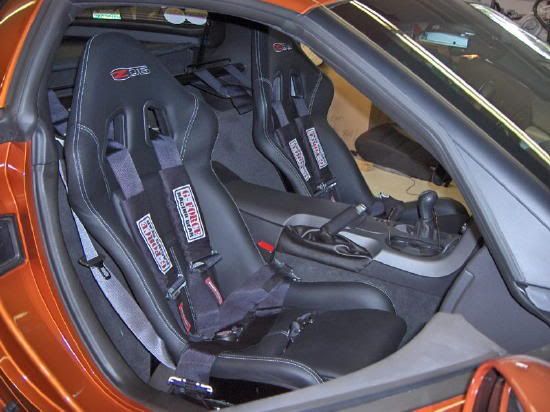

It's extremely important that the shoulder belts go from the harness bar, directly over the collar bone, to properly protect the spine, as in the photo.
