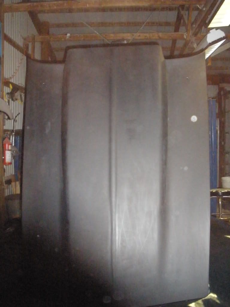

With weight reduction of removing all the wiper door and mechanism, and the BB hood.
Plus the addion of the supercharged 383 power plant.
Then the addition of the longer 74 low profile hood.
Left my air cleaner on the out side of my hood.
I wanted cold air induction and to stay as stealth as I could.
Here is the build and my first adventure in fiberglossing...
As I said I stated with a 74 hood and ordered a 2" cowl scoop from Jeg'S.

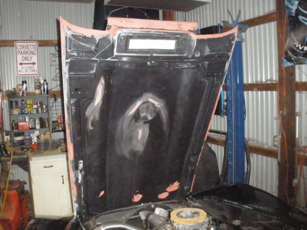

All cutting was completed with a rotozip tool.

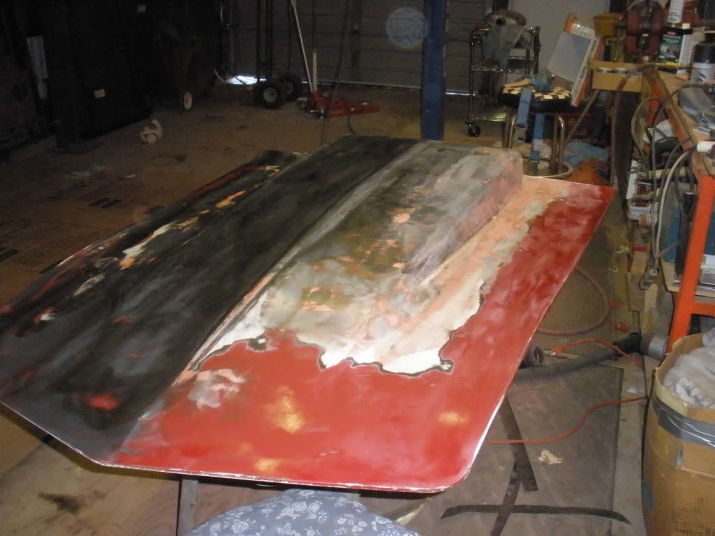

I then trimmed and added the scoop.
I cut the scoop to shape and used fiberglass cloth and resin to form it to the hood.
After several mistakes, a few yards of fiberglass cloth, hours of sanding, here is what I have at this point.

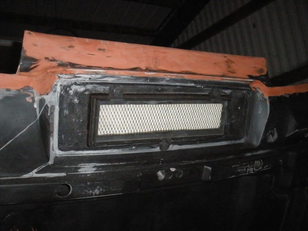

As you can see the carb draws air from the cavity formed by the scoop back threw the air cleaner located at the rear. It in-turn draws cool air from the cavity in front of the windshield where the wipers are located.
And this is what we end up with for now.
Any comments or suggestions are welcome.

Ivan i really like what you have done :cheers: it looks good,BUT,i think your setup is too restrictive for the supercharger,especially the filter you have on it.at lease go with a less restrictive filter,K&N maybe, paper elements are more restrictive.The blower would have worked best with a ram air setup.Again i do like what you did. Bill
I also donot use the paper filter that came with my scoop because of restriction,i eliminated the inside round filter and just run foam filter element in front.Works alot better.

You are correct. I only used the paper element as a template. I actually picked the filter from the K&N catalog. It is the same size in sq in as the ls7 filter in the Z06. I only used the $6 paper element in case I ruined it in the build process. K&N makes a filter that will slip right in there...:thumbsup:
