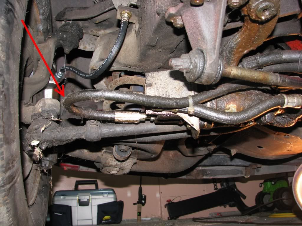

As you can see in these two pictures, there are some issues. Both might fall under the "Bubba" category or maybe just sloppy work, I know what I choose.
Wavy rag joint:
Incorrect power steering hoses:
The red arrow on the PS hose points to a spot you can't see in the picture, that when I removed the tire to do the brakes, the outside rubber lining right at that point was worn through to the metal flex cable inside. Not sure what rubbed against it as I haven't been able to check after I saw that.
So my question now becomes do I rebuild what's there with new hoses (Ecklers $70) and new rag joint (Ecklers $45) for $115+tax. That just means that the "does the job but no more" steering is now working as it used to. Or do I bite the bullet and get the Steeroids for $1,330?

The picture shows a shot rag joint,collaped steering column,and probably a worn box.
For a street car, a properly setup suspension with good parts,alignment, GM rag joint,and a blueprinted box will be as good if not better then an aftermarket system at 1/2 the cost.
Before all these systems were on the market corvettes handled extremely well with GOOD factory parts. The problem is most of the boxes you see offered are poorly rebuilt. You should be able to steer your car not aim it as some believe.
I have repaired way too many "rebuilt" boxes sold to people off auction site,catalogs,websites,and swap meets. They were all represented as rebuilt and ALL were junk. Most times they were just painted and over greased, no parts replaced and no where near the spec's they should be set to.
