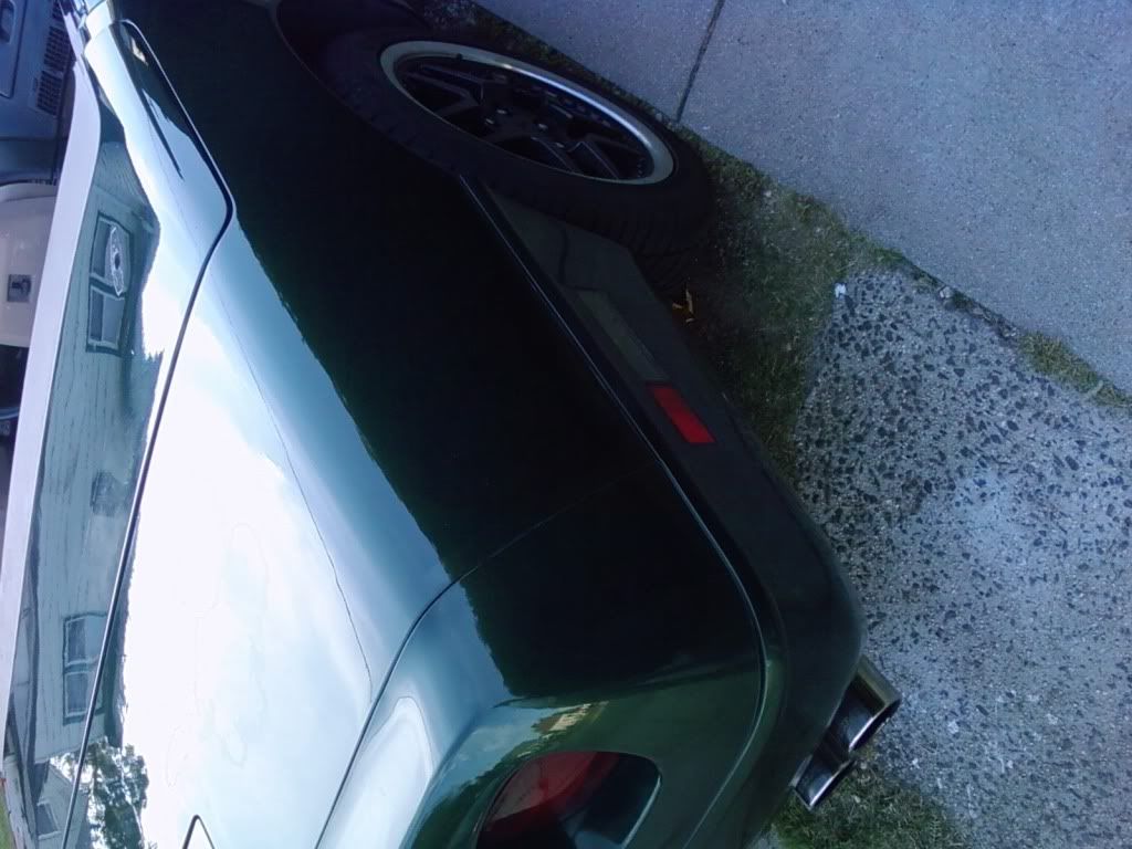

So I decided to follow Rottenrobs93's instructions on getting my paint to look somewhat decent...wow. After 6 hours non stop I got the back up to the doors finished..I'm wiped out..heres some before and after..took with a phone camera so it doesn't do it justice.
So now its a ...15 footer?? figure it will take another 10 hours to do the rest of the car..

What I don't get is how the paint came up so well without the clearcoat...so what is the purpose of clear coat.

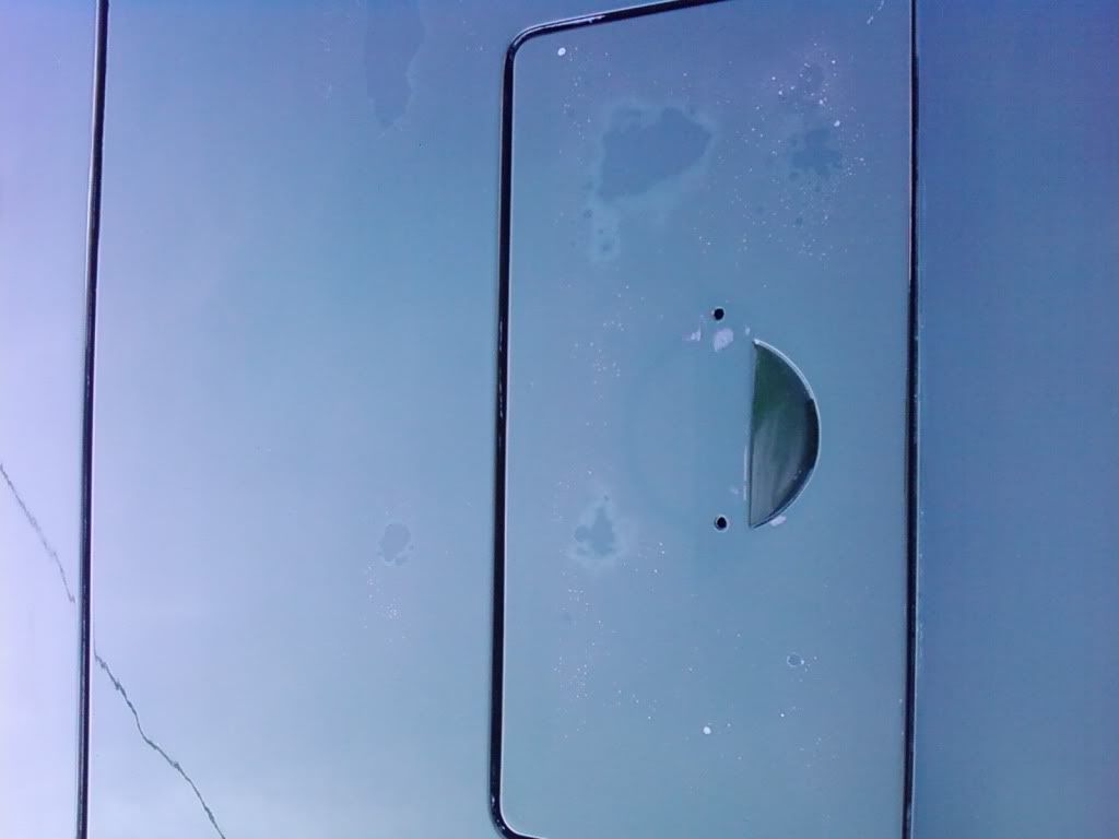

The picture of the gas filler door area is what it looks like close up..they ended up looking like dark stains, which is way better then white spots.

You won't have to do the whole hood. What you will end up with is a dark spot where the clearcoat is gone. I'm going to ...maybe..wet sand the whole car then compound and polish. it feels like glass when you are done but the wet sanding is tricky and takes a while. I read an article about doing this with new cars to get the orange peel out, costs about $900.00..lots of labor. I'll take some pics on Monday when I work on the car again..the black wheels really made a difference from the chrome ones...

NICE !!!! What did you use ?
32 Posts
Discussion Starter · #10 ·
I started with 1000 grit and wetsanded the helll out of all the areas that where bad. Once you start to see color its time to stop. then 2000 grit..then compounded the hell out of it with a rotary buffer until the areas without clearcoat shined..they ended up darker though. After compounding the hell out of the whole panel I polished it with Mothers polish and a foam wheel..then waxed it with Mothers carnaruba wax. next up is the doors..too bad someone did a lousy partial repaint on the drivers door which now has a big lighter color area. the front will be the real test..these hoods are huge.

MFI, Hope your somewhat happy with the results. It is a lot of work for something not show quality, but I think it's alot better then the dandruff look. :rolling: Mine to has darker paint where clear coat is gone. Again I did mine just to get buy as I save some cash for a paint job.
I didn't want ya cutting to deep to fast and being pissed at me so I told you to start with the 1000 grit. Now that you have a feel for it. I cut mine with 400 git to save time and work. Doing that though you gotta go light and be careful cause you will find primer if you don't pay close attention. Maybe jump to 800 or 600 for the start on the white areas.

I've spent about 10hrs on mine. Been bad about taking photos. I also only have about 3 hours in the morning, and about an hour at night to where I don't have direct sunlight on the car to buff it. I've got to get a better rubbing compound, the sanding scratches just aren't coming out, even with that, my hood is already 100x more reflective. I also found two thin spots in the paint, no color, no color, BAM, primer. WTF? But it's cool, it still looks 10x better than before. :cheers:

I started a different thread...see "you can polish a turd" its got full pics and pics of the wheels. Whats happening now with the rear deck..is the clear is starting to haze out again..its spreading..it might be terminal..so I may have to wrap that area and just cover the whole damn thing..have to come up with a cool design ...and it won't cost that much..the hood and the rest of the areas are holding up well though.

Yep, that's what's happening on my hood. The clear is just torched. The more I sand, the more it just spreads. It won't fade out for nothing. I finally just quit and trying to just polish her out for now. I'll be going with the 3m di noc wrap hopefully. Going to start with the targa and halo and see how that turns out. Good luck.

Someone was asking about why the paint is darker then the clear coat areas. I believe it is cause the UV rays have faded the clear leaving a light white tint to it.
