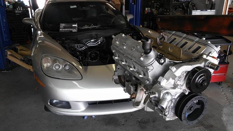

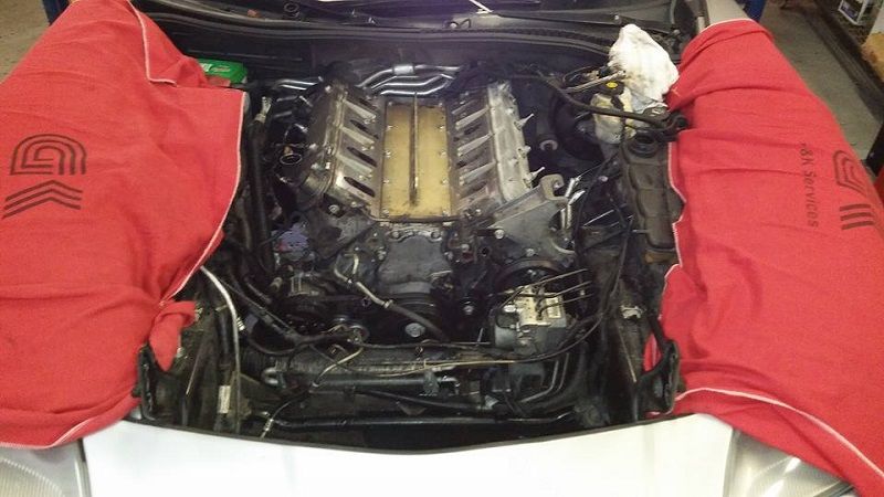

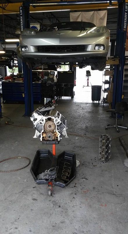

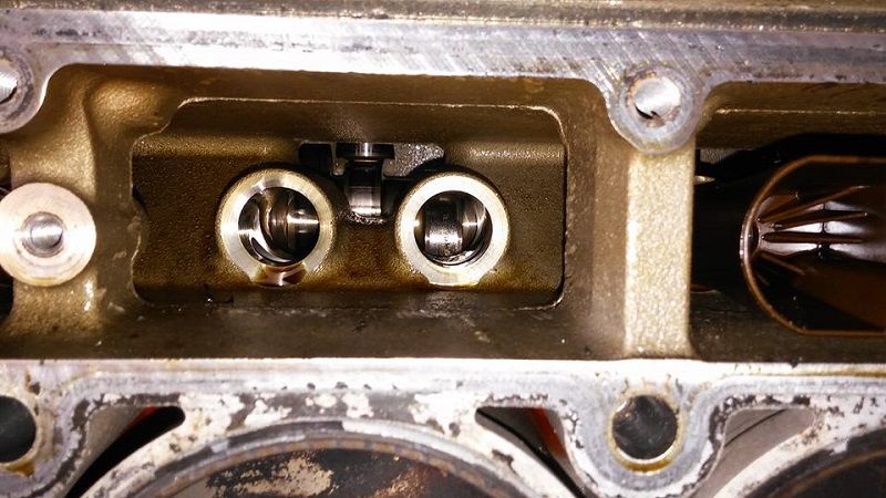

This car came in with a misfire. Only code stored was a p0300. We determined that there is likely a wiped cam lobe but the only way to see cylinder 3 intake and exhaust cam lobes are with the cylinder head off. So the motor needs to come out. Here is how I get an engine out of a c5 or c6 when I am in a hurry..
So the motor can come out of the top on a c6. If anybody was curious. And here is the head removed for cam lobe inspection..
And sure enough the exhaust lobe on cylinder 3 was chewed up..

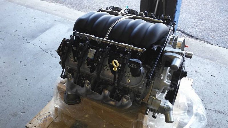

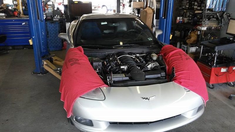

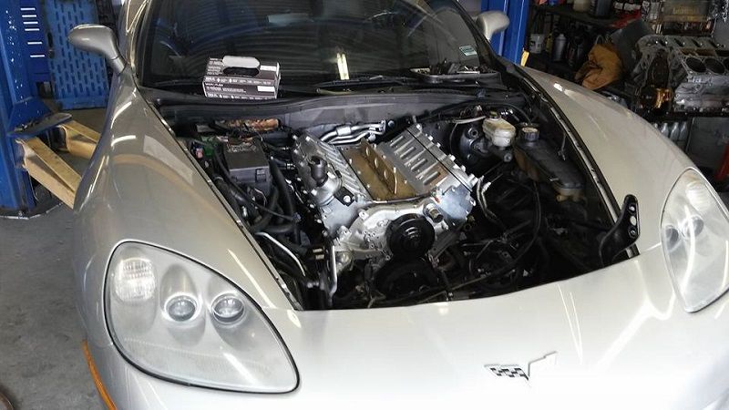

The engine has 121k on it, a wiped cam and a broken plastic timing chain guide. At this point the very minimum mandatory is a rebuild. But that's not what this thread is all about. No, this thread is about removing a bad LS2 from a 2007 and dropping in a LS3/480. Sleeper style. This car is bone stock. Stock airbox, Stock exhaust. The car will even retain the LS2 coil covers, even tho they will be lying.
#4 ·
Wait...are you saying the motor has to come out of a C6 to take the heads off? What about a C5? I hope I'm misreading that.

#8 ·
there's a trick to it for sure. the engine and car must be raised together about a foot up off the sub frame. Then the motor can slide forward and out. And we are a busy corvette shop, if this was just going to be a simple repair, I wouldn't have made a thread about it. I wasn't sure if this was going to get a ls3, ls3/480, or lsx376 but I knew it was getting one of them so I started this thread to demonstrate a ls2 to ls3 swap and how easy it can be done in a 2007(2005 is a bit more difficult).

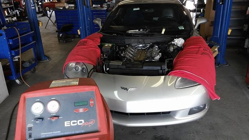

And the untrained eye will never notice the upper rad hose connecting to the water pump on the drivers side of the throttle body or the dexos oil fill cap instead of mobil 1, or the map sensor..
But there will be no mistaken above stock performance. This customer has good taste. Sleeper style. Internal engine mods only. No wild chop to the idle. Just a bunch of extra ponies as defined by a dyno roller and not the ear(noise level). Speaking of which, tomorrow we get to setup a tune for this with hptuners and then this can go home.
