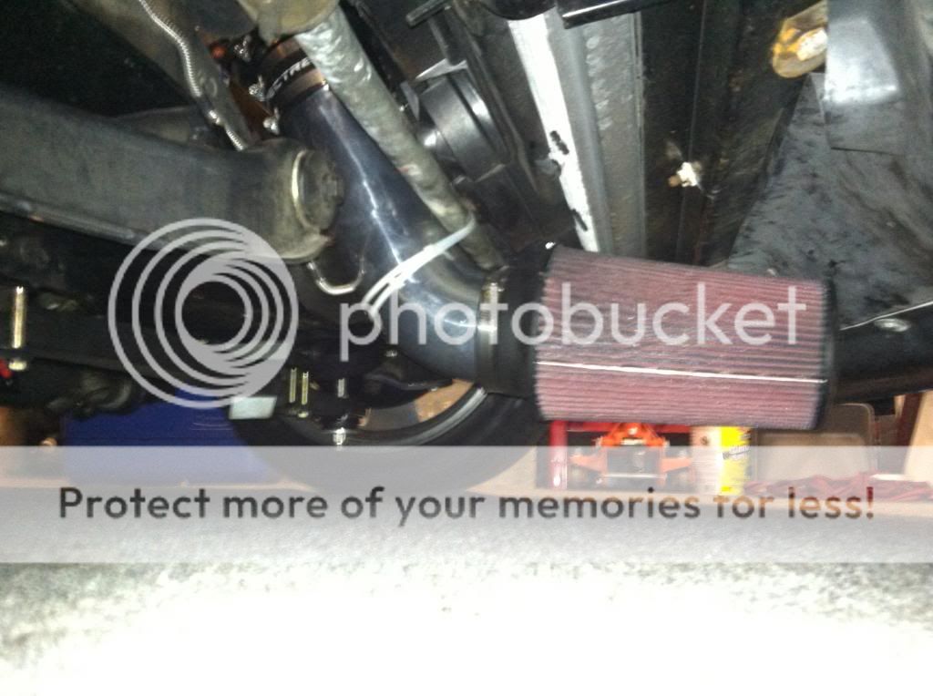

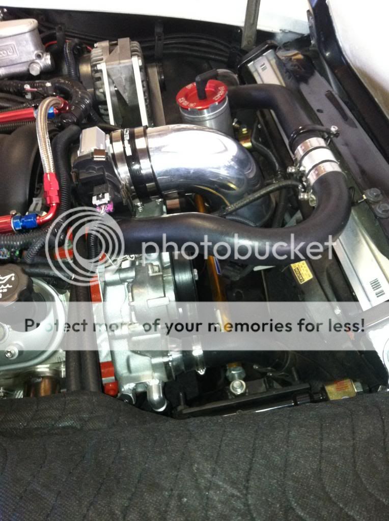

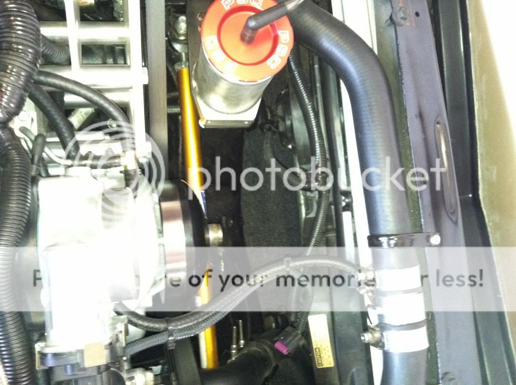

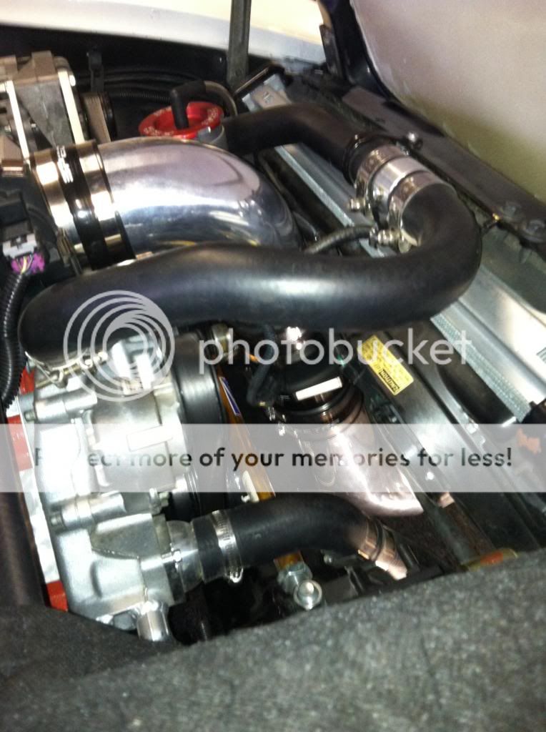

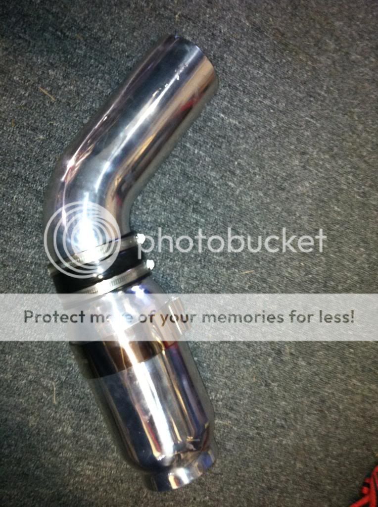

I have an update about this CAI. The inclosed filter that I used in this setup is VERY restrictive. I was at the dyno today with my new tuner friend and found that this cold air intake setup was rubing the LS of losts of power. With all the tubing and filter I lost nearly 20 HP with just the mass air flow sensor and the inclosed filter I lost 10 HP, that filter is very restrictive.
I am going back to my old setup with just a 4" 90 elbo, mass air sensor and a 9" cone filter on the end until I can come up with a new setup.
Terry

Some of the other CAI, I have been told to try don't seem to Have any flow numbers to support those ideals. I really thought my setup was good, my throttle response improved of the old elbow setup and it all seemed to work really well, but the dyno showed me a huge loss in HP that I'm not happy about.
The system has to be short, with minimal bends and preferably somewhere to get cold air. Straight forward and over the the core support is probably the best route, like the one Brent built for KOAS. Brent would you be in the market to build a few?? I'll take the first one please. Lol.

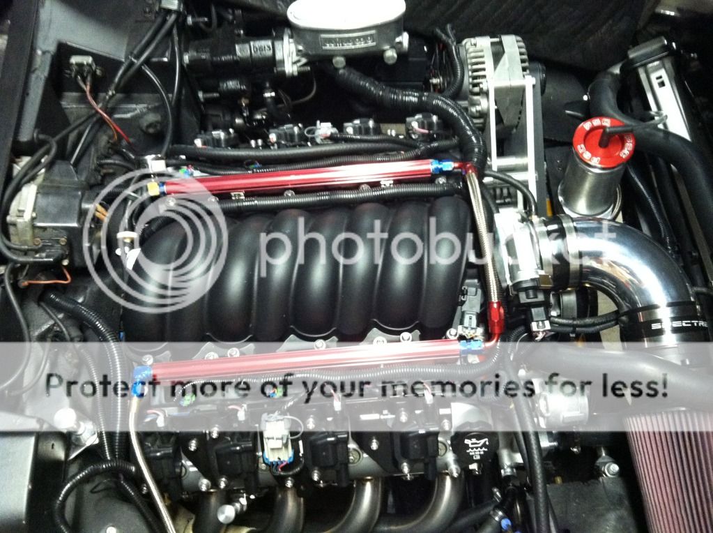

Dyno numbers were a little better than last time but still not where they should be with my 402, shameful. The motor is starving for air, not only through the CAI, but the stock LS2 intake manifold is to restrictive.
I forget the terms my tuner used but I was shown what the map sensor was reading while we were making pulls, as the rpms climbed, the map sensor was seeing the air intake struggling to keep up with feeding in fresh air, even when we eliminated everything but the mass air flow sensor, the motor was still starving for air. A stock LS2 manifold with 225 heads, 595 lift cam, and 1 7/8" headers don't seem to play well together.
I am looking at getting a FAST 102 LSXR manifold, possibly even ported from Vengeance racing, if the price is right.
I will find a way to get this motor to breathe as well as it should.
Terry
The flat filters are the least restrictive for obvious reasons. That inline filter is robbing you of HP because it is making the incoming air turbulent. The cone filter is better but still not ideal.

Well I think I'm solving one problem at this point. Earlier today I ordered a fast 102 LSXR polished intake from Vengeance racing. They have a great deal on ported intakes until Friday, 899 ported. Its normally a couple hundred more on top of the $830 price tag. So this should let the motor breathe like it should along with the short 90 and large K&N filter that Ill be using until I come up with a new design for a CAI. The intake is expensive but at this point it is what this motor needs.
