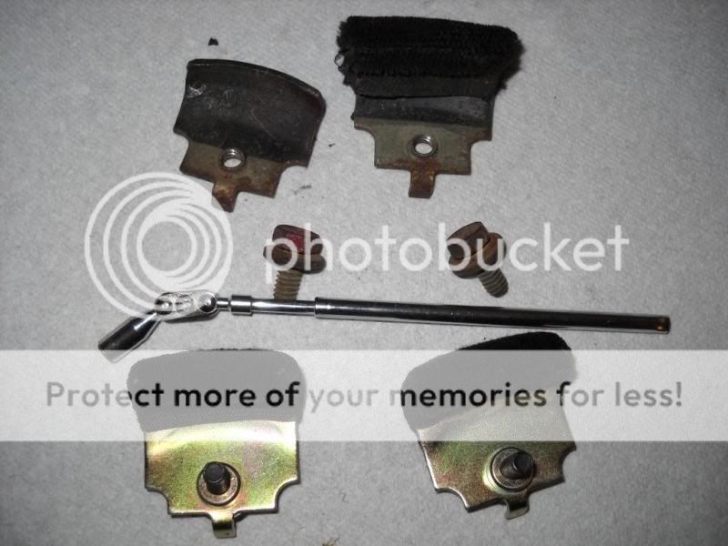

Here are the old and new pads for the driver door:

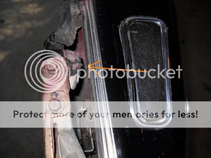

Here is the rear of the driver door and you can see the anti-rattle assembly attached but the pad is completely gone.
Along with replacing the anti-rattle pads, I tightened up all the bolts that hold all the window hardware secure and the doors really quieted down.
